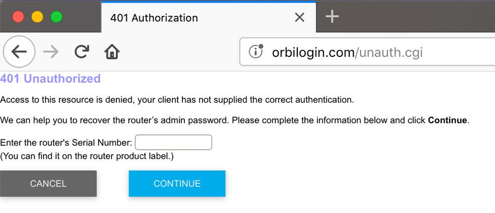

      non riesco ad accedere al telnet del router orbi.. mi chiede una password che non ho.. come posso fare per recuperare questa password?
      • ekhalil's avatar
        ekhalil
        Master
        pizzicante wrote:
        I can not access the telnet router orbi .. ask me for a password that I do not have .. how can I recover this password??
        Telnet password is the same as the admin password that you use when connecting to orbilogin.com. If you forgot the admin password then you need to follow the instructions that you get when you go to orbilogin.com by stating the Orbi serial number and answering security questions. Please see below:
        If you forgot the security questions then your only option would be to factory reset Orbi and start again from scratch.
