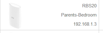

Recently I have purchased rbk20 and a rbk 40 for a better wifi coverage. Everthing works fine before this issue exists, I tried to rename the rbs 20 to ''parents-bedroom''.
However, in the m...

Tried and it shows my devices were connected to the main router(Rbr20). After that, I unplug the lan cable and it shows ''orbi satellite'' again.:manfrustrated:

Let me makes it clear, if I wire connected my rbs to rbk20, it shows all my devices is wire connected to the rbr20 no matter I am using wifi or not.
On the other hand, I am still on Orbi SW 2.2.1.210 and it is because if I check software update through Web GUI or the orbi app, it shows I am on the latest version. Should I manually update the firmware and what is the sequence of the update process? satellite first or the main router first?
- Jeremy_1208Mar 12, 2019Aspirant
Just manually updated to the latest firmware and reboot the router. Everything works fine and it shows''Parents-Bedroom'' again. Hope this firmware will be the stable one. Many thanks!
