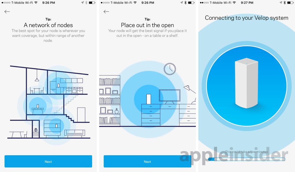

Hi I just wanted to say that from time to time one of my sattelites back haul will be listed as config sync, only way to fix it is by power cycling the sattliete and even then I had wasted about 30 mins of time till I finally decided to reboot my entire system due to the sattilte trying to reconnect to each other. This shouldn't be happening. I hope in the next firmware update this will be fixed. My setup looks a lot like this linksys velop picture on the far left. I wish daisy chain to be fixed.
