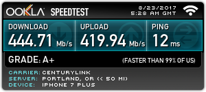

So it's been five days, and everything has been rock solid. Again, your mileage may vary, but updating to v1.12, wiping NVRAM settings via telnet and subsequently performing a factory reset, and never using the built-in Speedtest seems to have fixed my issues. My satellite doesn't appear to have dropped connections, the satellite is currently handling about 1/3 of the devices on my network, and my speed test results (from the website -- NOT THE ADMIN) are fantastic:
This is approaching the effective limit of what you can expect from a modern iOS device. I'm very happy with the results. Orbi is finally living up to its reviewer reputation.
