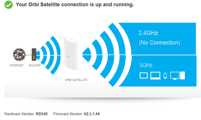

It seems alot of people are having issues with the recent firmware update. I only worked out I was having issues due to the Satellite placement in my house at the other end of the house. I started losing connection but my PC that is connected via a Network cable never lost internet at all.
Please see below. The main screen when trying to update the Firmware shows the RBS 40 and 50 "Waitiing for connection" and only one of them having the most recent firmware and then going into a "Manual Update" scenario, it doesn't even show the Satellites listed!
So I connected directly to the Satellies. Surprise surprise both of the Firmwares are actually V2.3.1.44. The router still thinks the 50 is on the older version?
Question is - how the heck do I get this to Sync.
For something so expensive this software team SUCKS!

      The RBS40 was literally doing nothing. It was pink on the app, it was "Waiting for connection" as well as the RBS50. I disconnected the RBS40 to try and sync it again as it wasn't doing anything. That was on Saturday. So nowwww I have an RBS40 that is a brick. Its constantly showing a blue light as synced but its not in the device list NOR is it in the app.  The whole time, every single time I logged back in the remaining satellite is "Waiting for connection". This is the remaining RBS50.
      I had so many issues with setting up the RBS40 that I didn't want to factory reset. So tonight I tried to "roll back" to .210. I DL the FW. I was able to actually find the IP address for the RBS40 that "doesn't exist" to the router. I rolled that back to .210 and I was able to roll the RBS50 back to .210. I was thinking I am on a roll! I DL the FW for the RBR50 and confirmed that I wanted to roll back the version and.... it looped, and looped and looped and looped saying please wait to the point nothing happened.. Tried again. Tried again. Tried a different PC to install it. Nothing. So now both satellies are on .210 and the RBR50 is still on .44.
