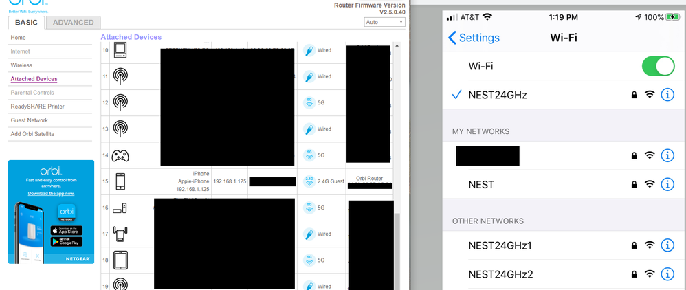

- SW_Dec 13, 2019Prodigy
Just tested with my iPhone and it seems to connect to my Orbi Router 2.4GHz SSID and works as expected.
Check out the attached picture!
