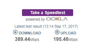

But when I run the speed test on the Orbi app or in the Orbi web interface I can expect half that speed:
389Mbps download 195Mbps Upload

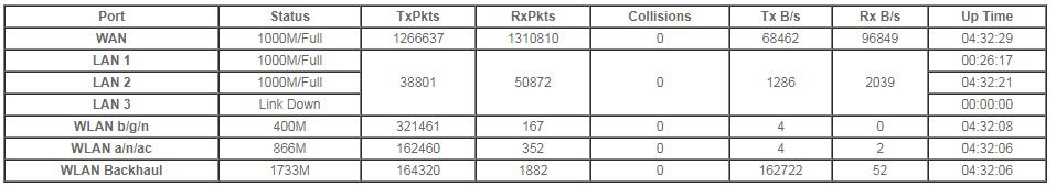

Just for fun here are my Orbi stats:
My wifi connection seems ok although my cell phone always seems to connect to my satellite even when I'm right next to my Orbi router. It just seems like the speed I'm getting is a bit on the slow side. What does WLAN AC 866Mbps really mean then?

JoelM3d I understood what you wrote. Speeds of 200 to 400 Mbps are as expected. The achievable WiFi speedsactually has nothing to do with your Internet connection speed.
1. The 866 Mbps link rate means this is the MAXIMUM rate that the router and a client can exchange data. This rate is only achieved under ideal conditions, such as in the same room, no obstructions between devices, and with no sources of interference. This rate is not achieved through walls, etc. The rate also adjusts constantly with time, and will be different for communications from the router to the client, and from the client to the router. The connection from the client to the router is often less, especially with a phone, which has weak radio, poor antenna, and is blocked by your hand. This is why uploads can be less. As I wrote earlier, the expected THROUGHPUT is no more than 50% to 60% of the link rate, so the maximum you should ever see is 430 to 520 Mbps on 5 GHz and 200 to 240 on 2.4 GHz. This is because WiFi has a lot of management traffic that eats up the link rate. So, your WiFi results of 200 to 400 are in the normal range.
