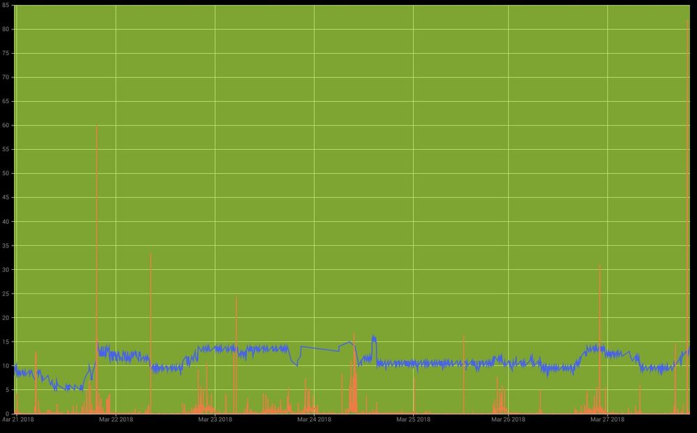

- yoda99beMar 27, 2018Aspirant
Hi all
just wanted to give an update after about a week in with the wired backhaul on 2.1.2.18. Eveything has been rock solid (hope I dont jinx it by saying it :) ).
I have my Orbi hooked up to my home automation controller "Homey" so I log the internet connectivity (green background), number of connected devices (blue graph), upload (lightblue) and download (red) speeds. So I am pretty sure that the Orbi hasnt been down while I was at work. Yeah... I completely nerded out on the graphs ;-)
I have been looking in the settings of the 2.1.2.18 settings and see lots of stuff I wanna try like Mu-mimo, fast handover etc but I think i'll just leave it all on the defaults. Just for the record, I dont have guest network or parental controls enabled so everything really "default".
Hope this helps other people.
