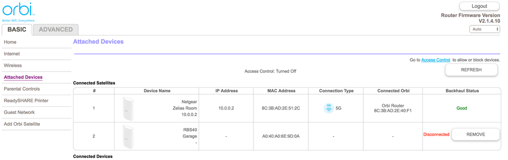

Router Firmware Version is V2.1.4.10
So I followed your instructions but the Satellite never switched over from wireless to wired when I plugged in the LAN cable from the router.
Now it looks like it does not even see the satellite in my Garage. This is strange becuase my reception is pretty good. 🤔
