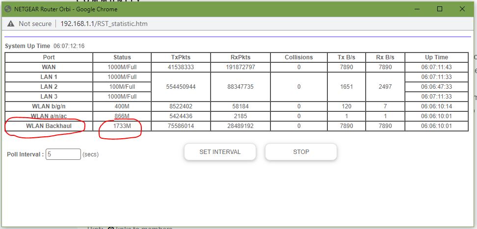

Is this the same as the web interface's Advanced Home -> Internet Port -> Show Statistics info?
That has a row for "WLAN Backhaul" with status as "1733 M", presumably Mb/s
Aloke
- CrimpOnDec 17, 2020Guru - Experienced User
alokeprasad wrote:
pe this is helpful.Is this the same as the web interface's Advanced Home -> Internet Port -> Show Statistics info?
Yes, my "Show Statistics" does report 1733 which is definitely different than the satelliteinfo. My feeling is that the 1733 is reporting the "maximum possible", just as the 1000/ful is reporting the maximum possible connection rate (gigabit). The actual rate (in my case is less).
