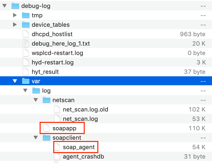

- It will be good to see what Orbi sends to the app to find out if it's Orbi that sends the wrong information or the app is the one wrongly interpreting the information. Please do the following:
- Close the Orbi app in your phone
- Go to the orbilogin.com/debug.htm page and enable "Save SOAP log between APP and Router".
- Click on "Start Capture"
- Open the app on your phone and click to open the network map
- Go back to the debug.htm page and click on "Save Debug Log"
- Save the zip file and open it.
- The following 2 files contain log of events interchanged between Orbi and the app:
- Open the files and search for wired and you should also see the satellite name.
