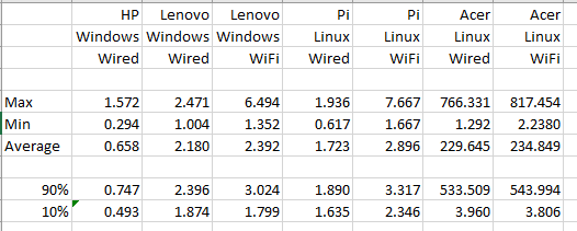

    What tools are available to you to investigate latency?  The "latency issue" came up on the forum last March, and I performed some experiments that concluded (in my case) that latency was partly a function of the WiFi firmware on devices.  I also had an arsenal of tools available to me:
    • Windows 7 Desktop for the test machine
    • Windows 7 Desktop as a test subject
    • Windows 10 Lenovo Laptop as a test subject
    • (old) Acer Laptop running Linux Mint as a test subject
    • Raspberry Pi 3B+ as a test subject
    I installed hrping, which generates ICMP requests (ping) with high precision. https://www.cfos.de/en-us/download/start-download.htm?file=/hrping-v507.zip
    I used hrping from the command line to send 5,000 ping requests to each of the test subjects, over an ethernet connection to the Orbi and when they were WiFi connected to the Orbi.  What I found was that (in general) WiFi takes longer than ethernet as I expected.  And, that the Linux Mint ethernet and WiFi drivers on that old Acer laptop are not great:
    I also did some ping tests with the Pi connected to my Orbi satellite, both wired and WiFi, and with the satellite connected to the Orbi with WiFi backhaul and ethernet backhaul.  (This is where that 50ft ethernet cord came in.)
    So, my conclusion last March was that MY Orbi did not exhibit excessive latency for three test computers, but did for one test computer.
    A lot has changed since March.  There is new Orbi firmware (2.3.5.30 and now 2.5.1.8) and there have been software updates to all of my test computers.  Even have a Raspberry Pi 4B that I did not have before.
    Sorry to ramble on.  My point is, "What tools are available to you to confirm that the Orbi is the source of the latency issue?"  Are there other devices in the house that will respond to ping (desktops, laptops, other?)  Do you have a computer that can generate and record pings?
