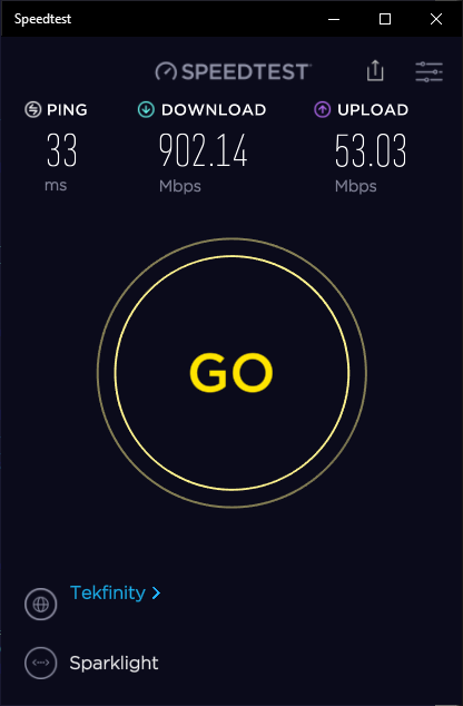

Try v16. I got mine loaded yesterday. Just took this test a while go with a wired PC connected to the back of the RBR50:
This is router mode btw...
If you update to v16, recommend applying the RBS first, then RBR lastly. Factory reset the RBR. Power OFF the isp modem for 1 minute, then back ON. Be sure your using a good quality LAN cable between the modem and RBR. CAT6 is recommended. Walk thru the RBRs setup wizard. Skip adding the RBS for now. Be sure you don't enable Armor, Circle, Access Controls, QoS or Traffic meter on the RBR. Go right in and speed test with the wired PC. Try a 2nd wired PC to compare.
