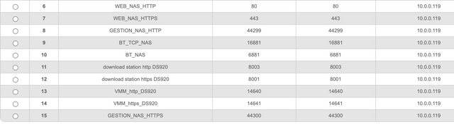

At the beginning I though it was upnp, so I disabled it and ass port forwarding:
https://www.dropbox.com/s/qafvbr8q7w3tgxc/Capture%20d%E2%80%99%C3%A9cran%202021-10-02%20%C3%A0%2022.53.02.png?dl=0
it works fine for some times, then stopped again, I reboot my orbi, boom working again.
