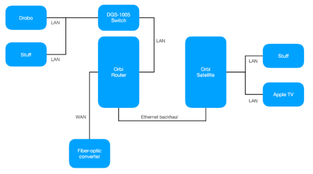

So if you connect the satellite in the same room via ethernet and let it settle in, then run some wired pings at the router and satellite while in the same room in this configuration, you see PLs here with a good quality CAT6 LAN cable? Even after a factory reset of the system and setup from scratch?

So if your up and running with wired back haul and not seeing any PLs, graduate adding devcies then and see if the problem appears.
Is the Switch still connected to the Orbi router? Just curious.

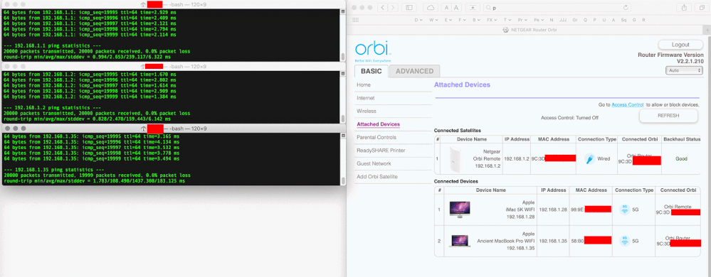

FURRYe38 Neither the Nintendo Switch or the DGS-1005D switch have been allowed back on. However, all the Ring Floodlight Cams, the doorbell and the Z-wave gateways are back. (I needed to restore power to the garage freezer. Please don't ask.) Some phones, a tablet and one Airport Express are on as well, 12 devices in total.
Looking good so far, this is from a computer connected through wifi to the satellite to the router, satellite and another computer connected through wifi to the router.
--- 192.168.1.1 ping statistics ---
40000 packets transmitted, 40000 packets received, 0.0% packet loss
round-trip min/avg/max/stddev = 0.908/2.673/244.120/6.409 ms
--- 192.168.1.2 ping statistics ---
round-trip min/avg/max/stddev = 0.854/2.482/212.241/6.583 ms
--- 192.168.1.35 ping statistics ---
40000 packets transmitted, 39999 packets received, 0.0% packet loss
round-trip min/avg/max/stddev = 1.758/4.609/222.301/10.133 ms
I think the Apple TV and then the Drobo will be welcomed back next.
