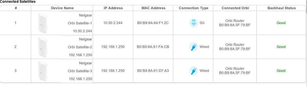

      • Sort of Good News is that Orbi is showing the hard wired backhaul on the two hard wired satellites.  Other news, something has changed.
        When I first hooked it up, the two satellites retained their IP Addresses *.242 & *.243 & connected devices began showing up under them.  A few hours later, I logged into the Orbi to find that the IP Address of the satellites have changed to 192.168.1.250 & there are no connected devices showing up.  Strangely, I can still hit the Satellites' GUI's by going to the *.242 & *.243 addresses.  The 192.168.1.* address space does not exist in our network.  The only device carrying this address space is the AT&T Gigapower Modem.
        Orbi is setup in Access Point Mode, runs into a Cisco 3750G-24TS 3L switch, & receives DHCP, DNS, from a Microsoft Server 2016 domain controller.
        Any thoughts on what is going on here?
