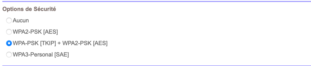

Bonjour,
Est-il possible d'activer le WPA3 avec le protocole WPA2 en simultané, certains périphériques (comme les Nest Cam par ex) ne fonctionnent pas en WPA3, or le routeur Orbi ne propose pas le mode WPA3+WPA2 comme sur les routeurs Nighthawk ... serait-il possible d'ajouter cette option dans l'interface svp ?

    My impression is that Netgear's description of WPA3-Personal is not vey detailed.  There is a WPA3-Personal "Transition Mode" which provides for both WPA2 and WPA3 device support.  The Orbi User Manual does not go into detail about whether Orbi WPA3 is "WPA3 Only" or "WPA3 Transition Mode."
    My first thought is that WPA3 is so new that common sense would indicate that Netgear has used WPA3-Personal Transition Mode in the Orbi.  (My second thought is that trying to predict Netgear behavior is not likely to be successful.)
    Have you verified that setting Orbi security to WPA3 makes it impossible for most devices to connect?
    (I would love to conduct an experiment, but as FURRYe38 has indicated, WPA3 is available only on the AX product which I do not own.)

      Hello,
      Yes I've discovered that issue by trying to connect my Nest Cam in WPA3 mode.
      In the interface you have just a 'WPA3 only' option sadly :
      No transition mode here.
