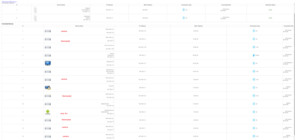

I’m 2 days and 19 in to using this latest firmware. So far, no reboots. I do have an Android phone (7.0) and also a chrome cast. I’ve kept the chrome cast turned off since it’s a known, unfixed problem. So far, seems pretty solid. Main complaint is it seems to be very biased toward using the Router vs satellite. I have a satellite maybe 6 feet from my wireless thermostat and it still connects to the router that is upstairs and across the house.
- budyJan 20, 2018Luminary
Yeah… I do have the same issue. A couple of my 2.4Ghz clients connect from upstairs to my router on the groundfloor, instead of the satellite upstairs. I am think about further reducing the 2.4GHz radio power… Currently, I do have both radios on both devices set to 50%, maybe tweaking them to 25% will mitigate this behaviour.
