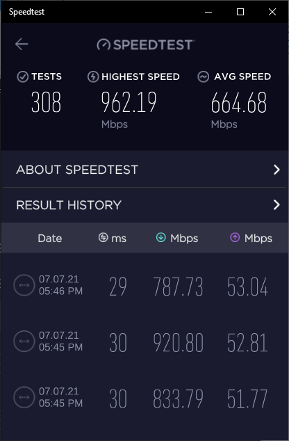

Jul 07, 2021Guru - Experienced User
With Circle and Traffic Meter enabled and other items working online.
- atanvarnoJul 10, 2021Guide
How do you get these speeds..? I have RBR50 for years now and ~550Mbps is max download it is able to show me.
I am on latest router fw (2.7.3.22) which I installed to see if it fixes the issue. I have 1000/200 Mbps speed on provider router which is then Ethernet-connected to Orbi, but can never cross 570Mbps download when testing *on the Orbi* itself. I have
When I connect MBP directly to ISP router, I get ~900Mbps over Ethernet. So when I see your speed screenshot which I assume are from PC which is Ethernet connected to Orbi, it's really puzzling how you get near 1Gbps.

atanvarno wrote:How do you get these speeds..? I have RBR50 for years now and ~550Mbps is max download it is able to show me.

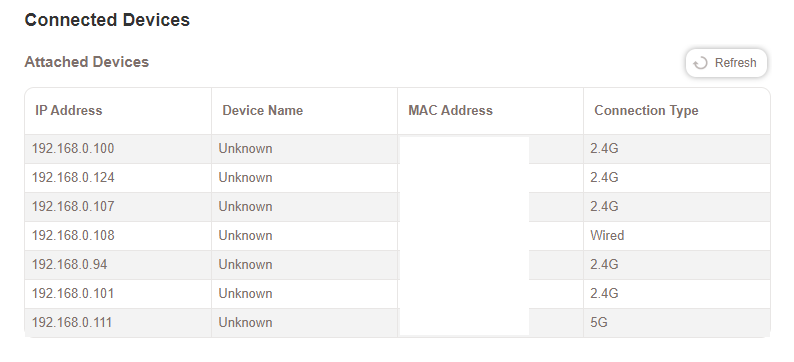

Well RBS and connected devices is working but Device Names is still "Unknown":
RBS50 is ethernet connected to the RBR using GS1 series switches.
