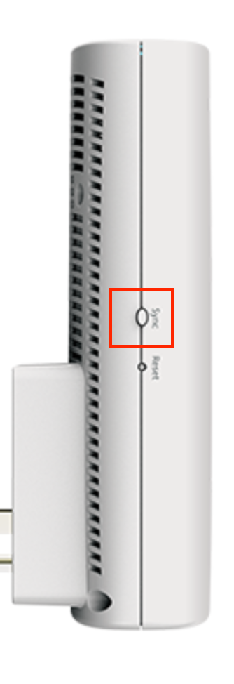

- ekhalilMaster
Follow the normal procedure of adding a new Satellite. Press the Sync button on the back of the Router and then also the Sync button on the side of the RBW30 (see picture).
