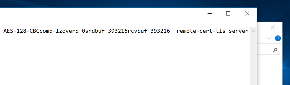

- No, I did not add that line to my config file. Is that simply added that to the send line? My config file is 1 line long...very long and nothing else. Do I add it with quotes or without?
Here is my current config file:
Only 1 line

rcvbuf 393216Not sure why it pasted as being multiple lines, that's why i included the image.

- TheRandyNov 20, 2018Aspirant
Also, opening the config file in notepad:
I added remote-cert-tls server without the quotes at the very end and when i go to save it, it says i dont have permission and need to seek file owner or administrator. I am the administrator on the machine, only 1 user.
- NemelaerNov 20, 2018Guide
Yes, that is what i saw too. So what i did was editing the ovpn file in the download directory and then copied the new / edited file to the config subdir. Here too the system complained about my rights, but there was the option to continue as administrator. And that worked.
The line is indeed to be placed at the end of the file, i put it right at the end, two spaces after the last character.
And indeed without he quotation marks!
Please inform about the result!

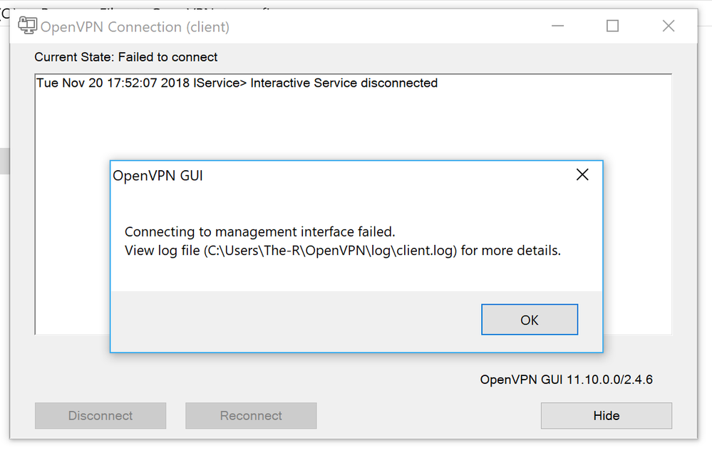

Thanks again for your help...i really appreciate it.
New Errors - New Logs...so maybe a step in the right direction. BUT, you're right, i'm not geting the "certificate" warning anymore =)
- NemelaerNov 21, 2018Guide
I am very sorry your problem still exists...
Btw, your client.ovpn contains exactly the same lines as mine, only mine is one long line without hard returns (in notepad), and no spaces between the lines as compared to yours (where there are hard returns). I wonder why you apparently downloaded another format...
What exactly are the "new ERRORs" you write about in your last post?
