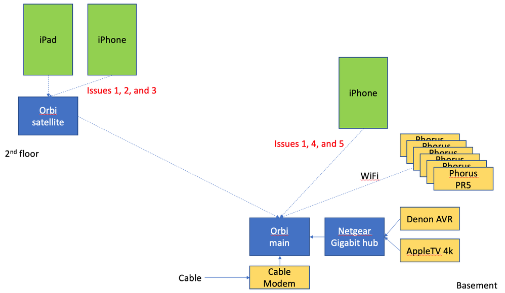

hi, I am struggling with a few issues with wifi on my Orbis:
  1. I have six Phorus PR5 receivers (these are hard-wired to an amp which is connected to wired ceiling speakers around the house and allow your phone to stream music over wifi).  The PR5s randomly show up and vanish in the list of Airplay devices, so i never know what I can stream to or not from my iphone.  These are physically right next to the main Orbi.  The issue seems to be worse when my iphone is connected to the satellite Orbi, but the main one has this issue too.  These have always been a little flakey but now seem almost useless they appear in the list so infrequently.  (They have all been upgraded to the latest firmware)
  2. My ipad seems to have an issue staying connected to the Orbi satellite that covers one end of the house including the master bedroom.  It will disconnect and reconnect from wifi multiple times in a few minutes when I first go upstairs and am reading on the ipad in bed.
  3. Even when the ipad stays connected it sort of acts like it is not.  Wifi is showing full strength but the network is HORRIBLY slow.  i often reload a web page several times to get it to go
  4. Just bought an AppleTV yesterday and I can't connect to it over wifi.  It is physically connected by Ethernet to a hub which is plugged into the main Orbi.  It's like the Orbi is not bridging ethernet to wifi?
  5. I was not able to get my iPhone to connect to my Denon AVR but it suddenly started working yesterday.
    The Orbis are at firmware V2.7.4.24 and say no updates are available.  All the other devices are updated to latest firmware/OS version.
    Any help would be appreciated!
    Here is a diagram of my setup:

      Yep, I was a network engineer for many years (but on large corporate gear; consumer stuff is a little alien since they implemented some of this differently (e.g., what Netgear considers a DMZ).
      >What is the size of your home? Sq Ft?   What is the distance between the router and 📡 satellite(s)? 30 feet or more is recommended in between RBR📡 and RBS🛰️ to begin with depending upon building materials when wirelessly connected.
      https://kb.netgear.com/31029/Where-should-I-place-my-Orbi-satellite ‌‌🛰️
      The distance between them is around 50'.  From the satellite to the iPad is around 15'.  The house is typical wood I-joists between floors, 2x4 and 2x6 wood studs, with wood flooring or drywall.

    • Stinky_W_Teats's avatar
      Stinky_W_Teats
      >Thanks for introducing the Phorus PR5.  The literature shows units scattered around next to separate audio systems.  Having six in one place is a unique solution.  This is an interesting option for someone who already has audio equipment and wants to stream music to it.  (Instead of, for example, buying Echo or Nest speakers and mumbling, "Alexa, play Rolling Stones.") If the existing audio systems are high quality, then this can essentially turn them into a "Super Echo" for only $30US.
      The idea of these is great for whole house audio.  a bunch of them plugged into an amp with 6 different physical amps inside connected to hard-wired speakers.  But in practice there have been headaches such as initially their app had to be used to mimic things like the iOS Music app, Pandora, Spotify, etc.  Later they fixed the PR5s to allow them to show up as AirPlay devices so i can now just use the actual iOS apps.  But they have mostly had this issue of disappearing from the list.  if i can get that fixed i would be a very happy camper!
      >The diagram is well done, thanks.
      Thanks.  It's simple but it gets the idea across.
      >Internet Service Providers (ISPs) often deliver service to basements when they use buried cables (rather than overhead delivery), so it is more convenient to locate the WiFi router there
      I had that done intentionally since that way i can centralize all the comm gear in a rack in the home theater closet.  (the HT Gear has its own rack)
      >Some customers need network service in the basement. (Which is different from "I'll put the computer stuff in the basement because that's where the router is")
      Our basement is finished and leads to a walk-out patio and outdoor room, so it is basically just another floor in the house
      >There is no mention of an Ethernet patch panel in the basement, so it might be safe to assume that equipment is not located in the basement "because that's where all the wiring terminates"
      The problems I am experiencing is all with gear connected with Cat6 cables directly from devices like the AVR receiver directly to the Netgear hub.
      I also have structured wiring but it is not involved in the paths where I am having issues
      >But basements often interfere with WiFi signals to the rest of the house.  "Other end of the house" brings up an image of the WiFi connection between router and satellite having to penetrate the concrete basement wall, through a lot of dirt, and up into the house.
      The floor between the basement and the rest of the house is standard wood I-joists.  There is not concrete slab between the basement and the rest of the house
      >When the iPad shows a strong signal in the upstairs bedroom, that is because it is relatively close to the satellite.  Those two devices have a strong connection.  It would be useful to know more about the connection between router and satellite.  Does the Orbi web interface Attached Devices page show the connection as "5G Good"?  See page 99 of the User Manual: https://www.downloads.netgear.com/files/GDC/RBK50/Orbi_UM_EN.pdf
      Yes, it shows as 5G Good.
