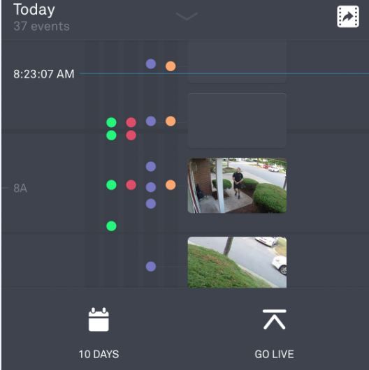

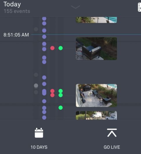

I just install the ORBI mesh system and although the speed is fantasic, my two Nest outdoor camera seems to be losing signal(disconnecting) several times a day. Over 10 minutes sometimes. This happen...

I had this issue arise just today. Always had intermittent issues but today cameras are just useless. I have updated the settings according to this post with no resolution. Hate to have to buy another router but not happy with Orbi.
