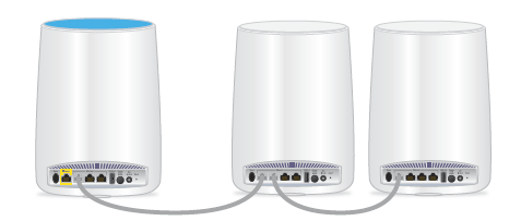

I cannot get this system to work with a wired back haul in AP mode. If I just use the Orbi Satellites all wireless with just the router connected to my ASUS it works perfect. As soon as I chain connect the orbis together it doesn’t. Meaning the router to the satellite, then from that satellite to the next. This causes all my Orbis to get purple lights with both satellites using an IP of 192.168.1.250. It’s funny I can access both, they flip flop. So meaning sometimes I enter it and I get 1 satellite in my bedroom then I enter that IP I get the one in my basement. This stays the case, & my asus router never seems to give it a different IP. I can fix this on the router (RBR50) by manually assigning the IP in the AP page. However this doesn’t fix the satellites which never change from 192.168.1.250 & don’t offer the option to assign manual IP. The interesting thing is.. if I don’t connect a wired backhaul I can leave everything alone. I don’t even have to set a manual IP for the router. Idk why this is happening. I have tried going into my router, and manually setting an assigned IP for all the Orbis. This didn’t work. Again it works without the wired back haul. If I plug them in they seem to all go back to 192.168.1.250 & stay that way. I tried lowering the DHCP range from 192.168.1.2-254 to 192.168.1.20-150. That didn’t work. I thought maybe it could be the Ethernet wire that I’m running to the satellite in the other room. I tried to just connect them in the same room without a long Ethernet wire. Resulting in it still not working. I am at a complete loss. Any help would be appreciated. Thanks =)

      The firmware is the latest 2.7 Orbi firmware. However this has happened on every firmware release. As for switches. I have two connected behind my Orbi to the satellites. They are Netgear GS108s unmanaged which are supposed to be compatible. I did this to add more Ethernet ports for more hardwired devices. The thing is I tried all the basic troubleshooting. I removed the switches, I tried DHCP reservation, I factory reset everything, I tried changing the Ethernet cables. I have these all chain connected when I use the wired backhaul. I don’t have an Ethernet wire running from the RBR50 to a switch than the RBS50s. I instead am connecting it strait to each satellite from the RBR50. Going down from the router. As for the ASUS it’s an RT-AC5300 with the latest firmware. However, even when I use a different router as the main it still functions this way.

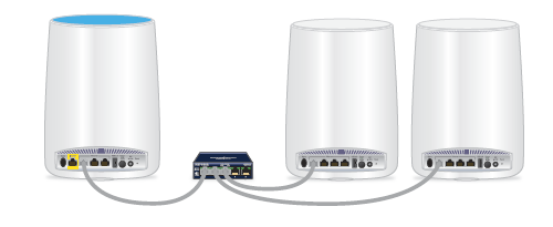

        This is the way I have it connected. NOT WORKINGThats my exact switch
