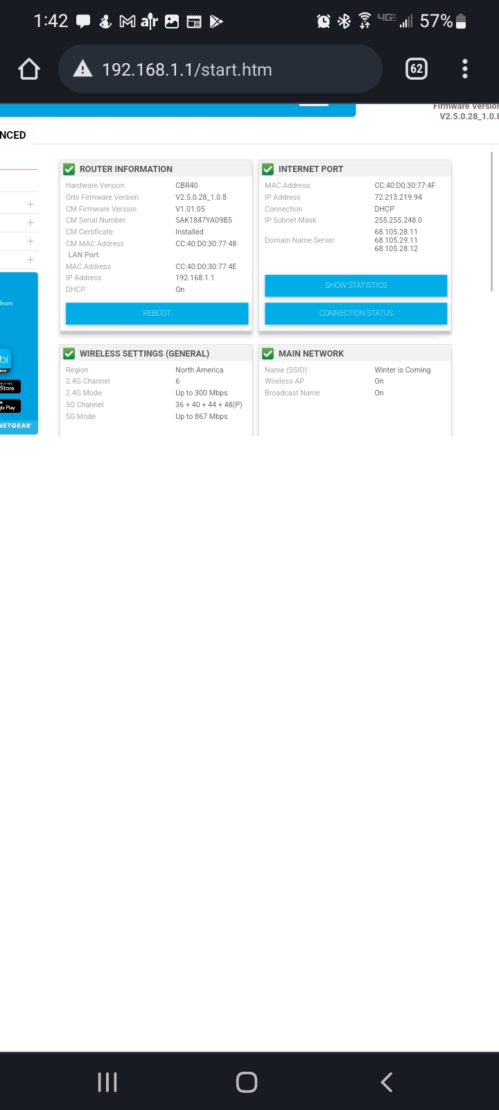

Here's the event log from the most recent drop. Again any help would be appreciated. I really don't want to have to buy a new router/modem right now but can't continue resetting and waiting several minutes for the modem to reboot 2-3 times daily. Also, I have two satelites connected wirelessly. One is in my garage and other in my kitchen. Each is 20-30 feet from the CBR40 and they are probably 40ish feet away from each other forming a triangle. The kitchen satellite is an RBS20 and garage one is an RBS50. I originally had just the RBS20 but added the RBS50 last summer and have been using this setup for nearly a year without issue.
Jun 23 2022 14:36:31 Warning(5) MIMO Event MIMO: Stored MIMO=-1 post cfg file MIMO=-1
Jun 23 2022 14:36:31 Notice(6) TLV-11 - unrecognized OID
Jun 23 2022 14:38:29 Warning(5) MIMO Event MIMO: Stored MIMO=-1 post cfg file MIMO=-1
Jun 23 2022 14:38:29 Notice(6) TLV-11 - unrecognized OID
These messages are all over the event log for the last 8 days (only shows last 8 days of events). Another one that shows up periodically is
Critical(3) No Ranging Response received - T3 time-out

A full screen snip of the event log and the cable connections page helps the most for checking the line.
But a few tips for troubleshooting cable coax lines.
Start with removing any amplifiers, signal attenuators, or splitters from the coax.
From there check the line for kinks, damage, moisture in the line.
Check the connectors for improperly made ends, foil touching the copper coax line, bad/old/cheap connectors, or corroded connections. Replace them if you do.
If you can, simply connect the modem right where the coax comes into the home. This prevents wiring in the home from being the issue. And some ISP’s charge if the wiring issue is in the home. So this helps prevent this.
