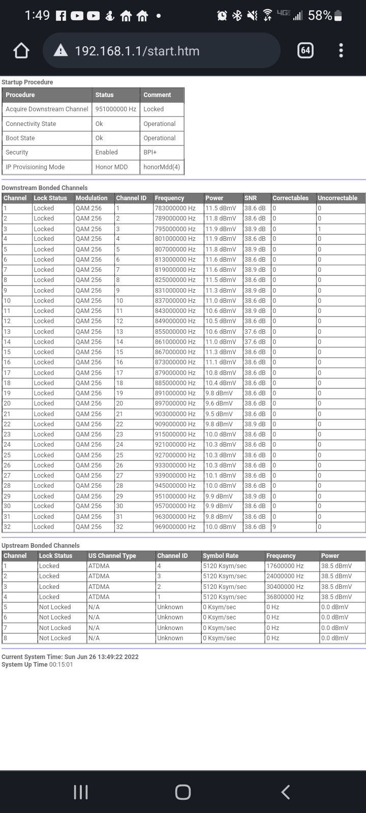

Just put the splitter in. Didnt bring the power down as much as you wanted but it is better. I also moved the router/modem further from my TV since I have the extra cable length now with the splitter. I'll give it a couple of days and see what I get. I also ordered a 10dB attenuator from Amazon that I'm thinking I'll put in place of the splitter. Thoughts? Attached is the results after the splitter install.

10db attenuator is quite a significant jump. You can try it but make sure to take the double splitter out. Normally, I'd rather see the signal on the high side versus low side. reason why is if the downstream is high, it usually means the hub is closer to the home and so it doesn't take the modem as much power to communicate with it. If you're to low, it means its further away and the modem has to increase its output power to compensate.
- YrokJun 25, 2022GuideIt has dropped again since installing the splitter and moving it further away from other electronics. The 10db attenuator should put me around 2-3 dbmv. I figured getting as close to 0 as possible was the goal when I ordered it. Either way, not sure it's going to help or not since it's already acted up again at the 9dbmv it's sitting at now. I ordered a new coax too just to rule out the cable. Both the attenuator and cable should be here Monday...fingers crossed that they fix my problem but I'm not very optimistic. Latest log is attached too. Installed the splitter around 1300

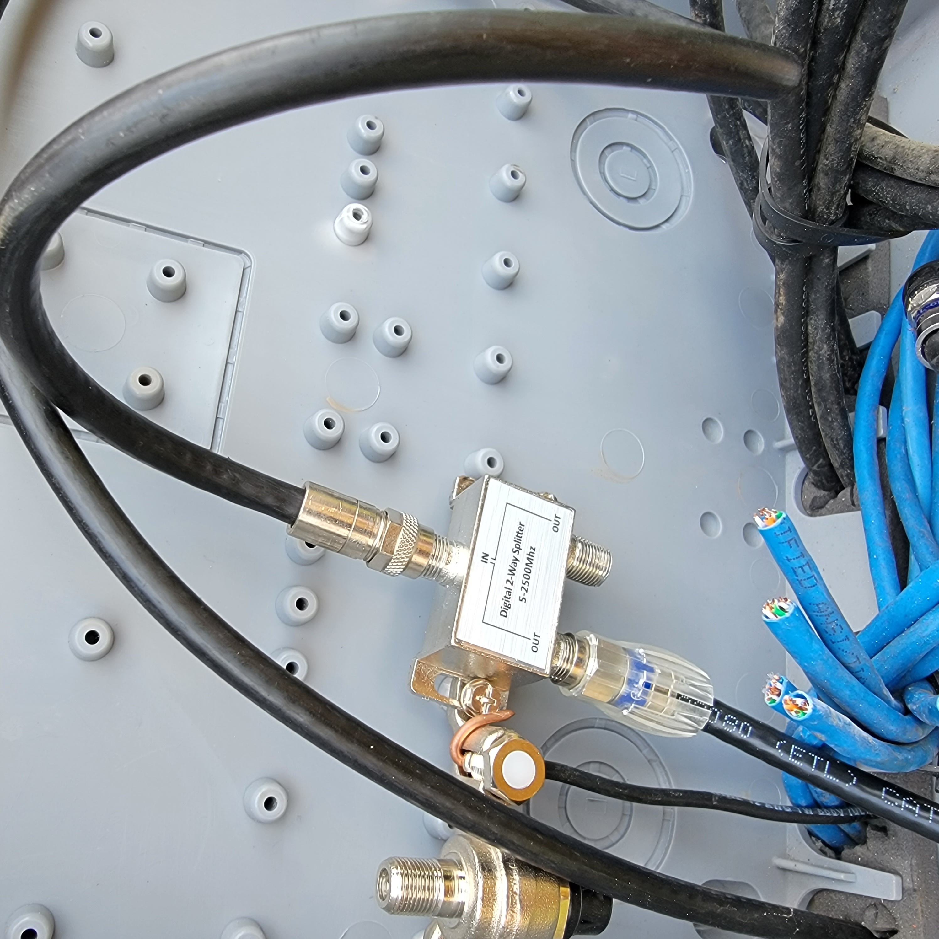

- YrokJun 26, 2022GuideThis is outside where cable comes in...not sure how to undo what's there to plug directly into modem
- plemansJun 26, 2022Guru - Experienced User
It looks good externally. but I've seen poor crimping/stripping jobs where the shield was touching the copper coax line though. so even though it looks good, externally, sometimes you have to check all the connections. But if the issue is outside the home, its on the ISP.
I've actually had to rent a modem before to prove to an isp that it wasn't the modem as they wouldn't troubleshoot anymore without charging me for it. Not saying 100% it isn't the modem as a hardware issue with the modem could give you errors too, its just something I've had to do.
- YrokJun 26, 2022GuideOk. Directly plugged into the line coming into the house.(except for the 6ft cable attaching it to the modem). Attached is how it looks at the moment. I know it's not pretty but it's only temporary. Without the splitter, the signal was very hot (15dBmv). With the splitter installed as shown, the power levels are around 12dBmv. Unfortunately I don't yet have the 10dB attenuator. I will post the event log after 24 hours.
- YrokJun 26, 2022GuideDirect hookup no splitter.
- YrokJun 26, 2022GuideDirect hookup with splitter.
- YrokJun 26, 2022GuideAttenuator was in the mailbox. Replaced the splitter with it outside where the cable comes in. Attached are the power readings. If it still drops now, I guess I'm at the point of contacting the ISP.
Yeah those power levels are pretty spot on perfect.
