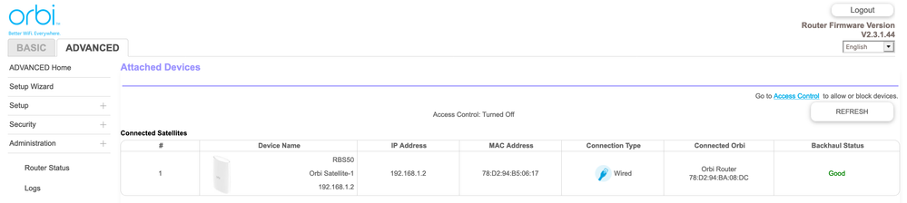

- ekhalilApr 11, 2019Master
Itsjustinyo wrote:
........ The setup has been connected for a couple days now so hopefully it would have prefered the wired connection by now. I feel like something else is missing.
Please check that the used cable is ok. If you have a good cable you should see that the connection type changes to Wired after few seconds.
Here is how the Attached Devices should then look like:
