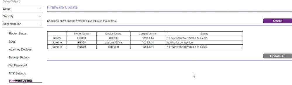

I got the system set up and originally I was using wireless backhaul for everything. After three days though one of the satellites turned orange on the Orbi app which appeared to indicate a degraded backhaul experience (the documentation was terrible). My speed tests indicated I was only getting about a 25MBPS on the download when I was getting almost 300 prior to the orange status.
I decided to change it to a wired backhaul (already had the cable upstairs) and the light on the Orbi app went to red and wouldn't connect at all. So, I moved the satellite right next to the router, plugged it in and all was good (green across the board and wired backhaul). I then moved it back to it's original location. This is where things go bad.
The android app now shows it as offline and doesn't recognize it as another node. I can ping the satellite just fine (by the way the router is in AP mode). In the web admin console it shows the satellite as connected and wired (see image 1).
However, when I got the admin settings to check the firmware version the web app doesn't find the satellite either.
But, when I go to the far end of my house (that's only reachable by that satellite) on my speedtest I get 300MBPS again and all is good.
I'm not sure if this is a bug in the android app and the web interface or something else. Any ideas anyone?
    The fact that when changing the cable to a shorter one the wired backhaul worked, shows that the cable is bad. Is it possible to troubleshoot the cable?
