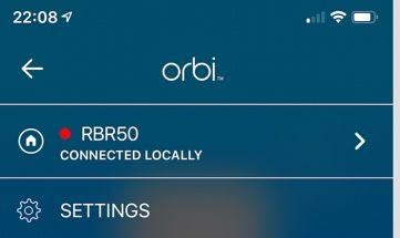

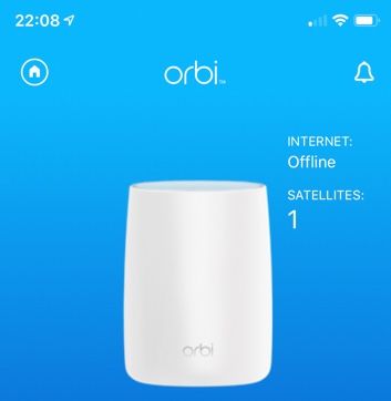

My Obrbi app is telling me the Internet is off-line however, I can send emails but, I can't download apps to mobile devices.
My system is in the UK using a BT modem - I bypass Orbi and select the BT Hub, I can down load apps.
from appfrom settingThis is a relatively new issue!
