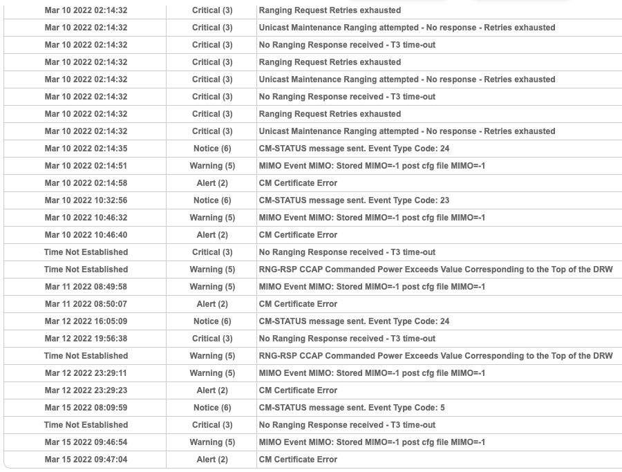

My internet connection drops every 3-10 minutes. I have called my ISP (Spectrum) many times and they claim it is not a problem on their end. I have attached a screenshot from the connection monitor Chrome plugin.

      The event log is below, I don't know what the "cable connections" page is, can't find it in the web interface.

        The cable connections page will show upstream/downstream info. When you first log into the device, click on the internet icon on the home page. (through the gui)
        Your logs are indicating a line issue currently.
        Start with removing any amplifiers, signal attenuators, or splitters from the coax.
        From there check the line for kinks, damage, moisture in the line.
        Check the connectors for improperly made ends, foil touching the copper coax line, bad/old/cheap connectors, or corroded connections. Replace them if you do.
        If you can, simply connect the modem right where the coax comes into the home. This prevents wiring in the home from being the issue. And some ISP’s charge if the wiring issue is in the home. So this helps prevent this.
