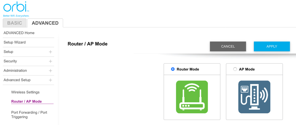

Thank youYour ISP Router (Internet Box) is still a router (even though you disabled wifi on it) and then you added another router (Orbi) so there you will have two sources for IP addresses and this will just give you different headaches.
Please do one of the following:
1) Bridge the ISP router or configure it's DMZ to go to the IP address assigned to Orbi in the router.
2) If the router does not allow you to do this, then set Orbi in AP mode instead (using the Orbi GUI on orbilogin.com). Please see below how to set Orbi in AP Mode:
