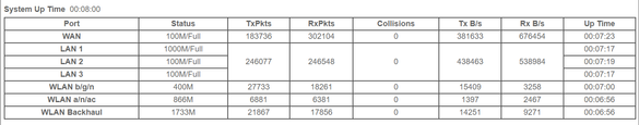

    What is the connection rate seen on the RBRs web page under Advanced tab/Show Stats for the WAN port connected to the ISP modem? 100 or 1000Mbps?

        One easy diagnostic is to open the Orbi web interface, navigate to the Advanced Tab home page, and click on Show Statistics.  This will report the speed that the Orbi Ethernet module has negotiated with the Ethernet module on the Hub 5.  Wikipedia explains how the Ethernet hardware negotiates the maximum speed supported by both devices:
