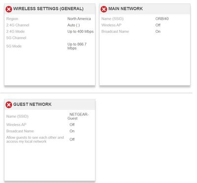

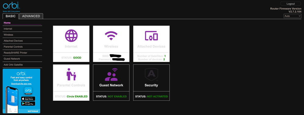

Now I have no Wireless network whatsoever, the orbi app does not work at all. When I connect throug the web admin interface, I get this:
And on the Advanced Home Status I get this:
I have done hard resets, 30-30-30 resets, I have downgraded and upgraded versions.
NOTHING WORKS!

When the Orbi is "Factory Reset" (30-30-30 is the same thing), then the entire configuration is erased and the Orbi has to be configured from scratch. You did that, correct?Yes I did that, and indeed I had to do the whole configuration from scratch, and the message appears the same...
Wireless "Warning: OFF"
Thanks for the info on the images. I uploaded the first image, and I am uploading the other one in this post.
