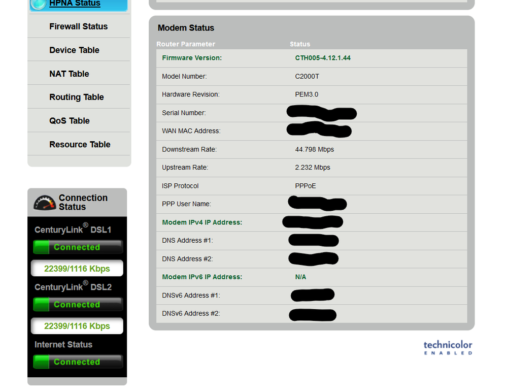

This is a screenshot showing the modem status page of the Technicolor C2000T. As you can see I have a bonded connection. This screenshot is before I attempt to turn on transparent bridging. Up to this point the internet is working and connection is good.

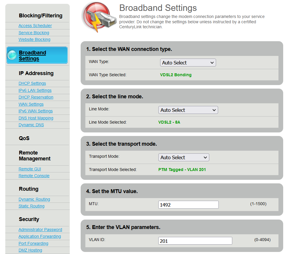

This one shows the Broadband settings of the C2000T before I attempt to turn on transparent bridging.

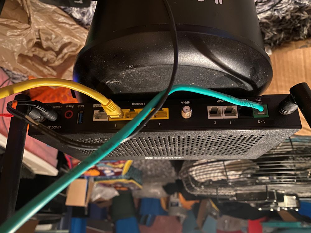

My Orbi is connected via ethernet to the Centurylink modem and the connection is also good before I begin the transparent bridging process.

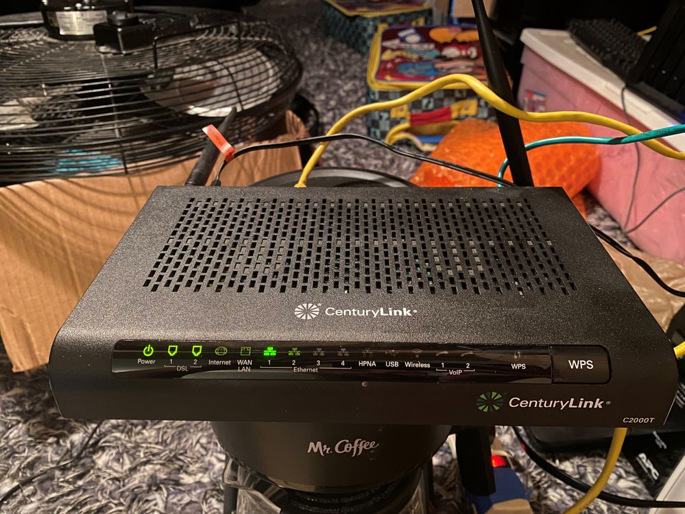

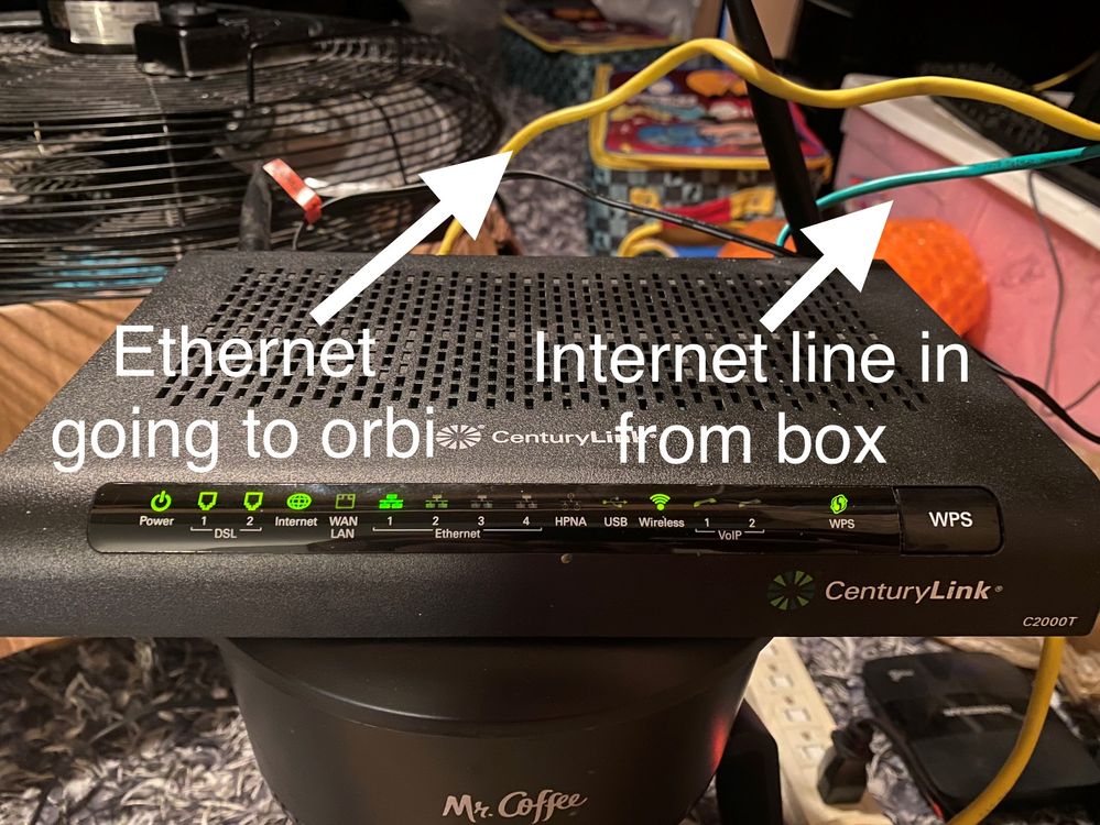

These are how the lights look before I attempt to begin transparent bridging.

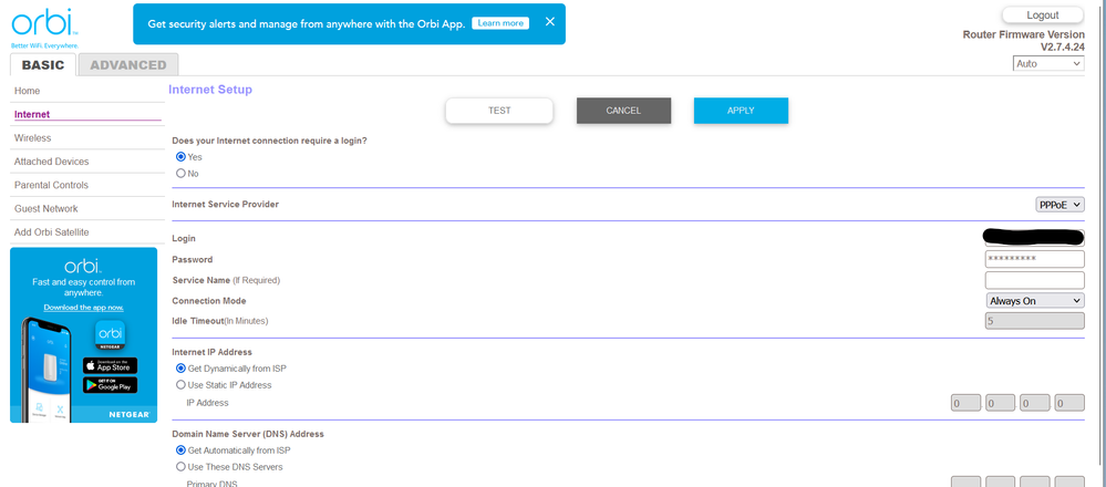

2. Then, on the Orbi, under Internet Setup, I entered the PPPoE credentials.

This is what the lights look like on my Centurylink modem after attempting to setup transparent bridging:

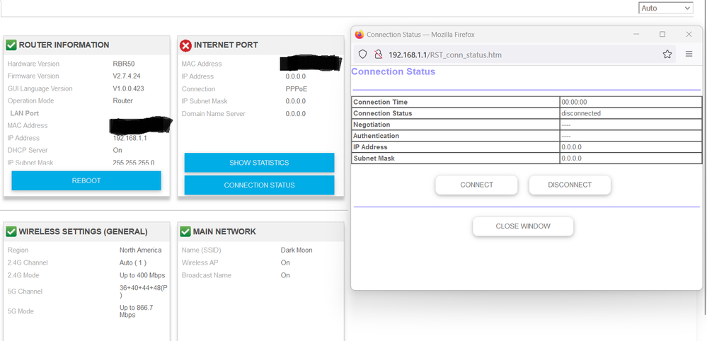

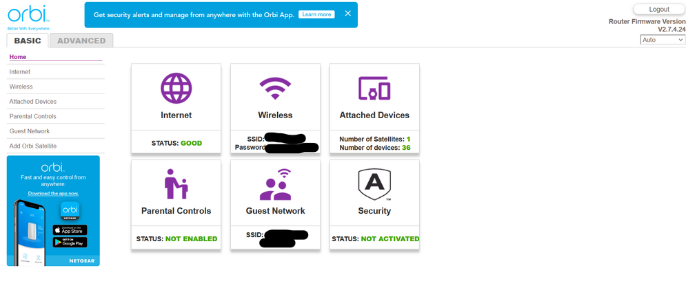

And this is what the Connection Status page shows on the Orbi:

The second thing I did was instead of selecting “transparent bridging untagged”, I selected “transparent bridging 201”.
