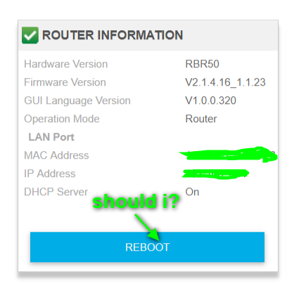

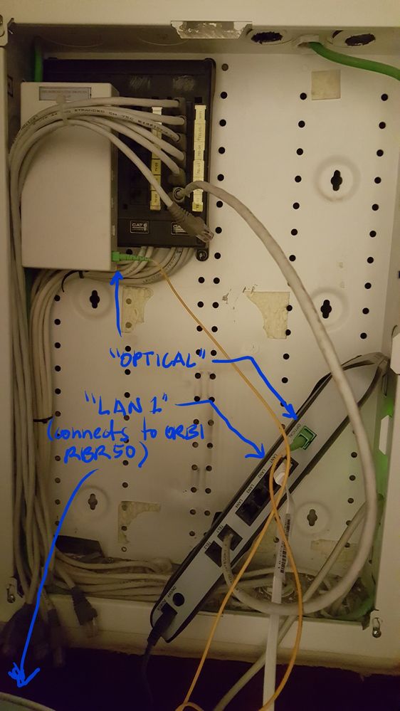

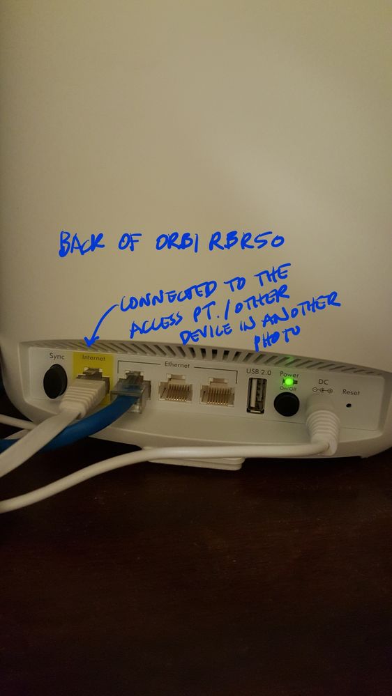

- jiacFeb 03, 2019Guide
Is there anything else on your network? The modem, for example, what is it?
I took snapshots of the setup in my apartment. Please note that these have been setup by others and we are just end users (I'm not a very technical person):
This is the router information from the admin panel:
Thank you.
