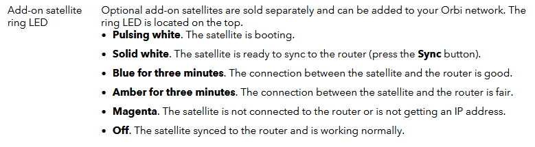

Does this happen when the satellite is temporarily relocated to the same room as the router?
i.e. there is no sequence of the ring LED pulsing white, turning solid white, and then either Blue or Amber for three minutes?
From page 10 of the User Manual:
