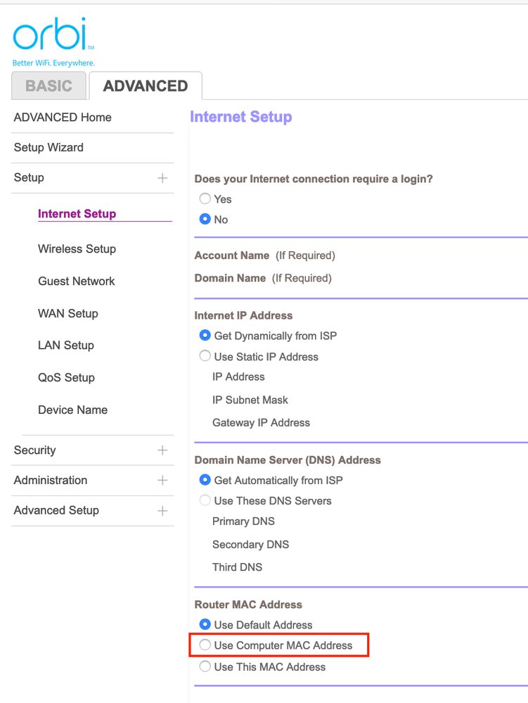

- Change the MAC settings for the WAN port to "Use Computer MAC Address", as follows:

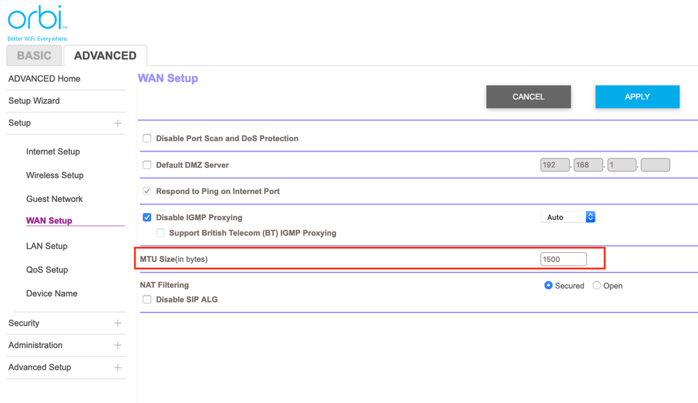

- Change the MTU size to lower values, by default it's 1500, try 1492 to start with:
