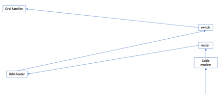

Hi All,
I have a question on Orbi topology. To my understanding the default topology would be as in picture one where I have to do double cabling if I want to use ethernet backhaul to connect to Sa...

Is there some instructions on cabling for this setup? I assume on the Orbi Router I only connect Ethernet port to the switch that I have and connect the other Orbi satellites to the same switch?
Oct 09, 2018Guru - Experienced User
Yes you can connect the satellites to the same switch with the main Orbi base. Or have a switch in between the base and satellites.
What is the Mfr and model# of the ethernet switch? Managed or non Managed? There are known problems with Managed switches and Orib systems on wired backhaul. Mainly IGMP protocols.
- zeegeOct 09, 2018Aspirant
So you are saying that the Topology picture #2 would work assuming my router would provide DHCP and other needed functions. Orbi Router + Sattellite would work as Plain APs that would work in a MESH? I am using an HP 1810-8G(J9802A) switch but it seems that it does not support Layer 2 Multicast (IGMP) snooping. I see no problem in updating the switch as long as don't need to do extra cabling.
- FURRYe38Oct 09, 2018Guru - Experienced User
Yes, I believe that scenario should work. I've always connected the switch after the router for my system and then the satellite to the switch. I have two switches in between the router and satellite now.
If the switch is non managed or doesn't have IGMP enabled, you should be good to use it. Those a good switches. I use several HP switches in my mix.
