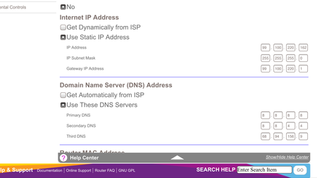

Orbi using Uverse and Slingbox 500
I have an Orbi system behind a Uverse Motorola NVG589. I have read the directions and turned my Uverse modem into bridge mode as much as allowed. (see here) I am not 100% I have done it correc...
I am not 100% I have done it correctly, so I have taken screen shots of my Uverse and Orbi setup.
The problem is, I am having difficutlies with getting my Slingbox 500 (192.168.1.182) to work outside of my home network. This was working with my previous setup. I previously had a Nightgear Nighthawk as an AccessPoint and the Uverse router being the router.
It looks like the Uverse is now set to use 192.168.2.x addresses, but you are forwarding to 192.168.1.x addresses.
If you are using Orbi as a router, you need to forward all those ports in the Uverse to the Orbi. Then set up forwarding in the Orbi to get them to the real destinations.
BTW, your images are still in the moderator queue for approval - that might be because they show your public IP address. Most people won't be able to see them until they are approved.
- russellmoran99Nov 10, 2016Luminary
Correct, my Uverse is set to 192.168.2.X and my Orbi is 192.168.1.X. According the link I posted above, that's what I believe it told me to do. Am I incorrect?
- peteytestingNov 10, 2016Hero
if you upostream device is bridged why are you setting the orbi to a static ip address ? in most cases even if you have a static ip address with your isp you still use dynamic ip on the wan connection as the ip address you get is just reserved at the isp
