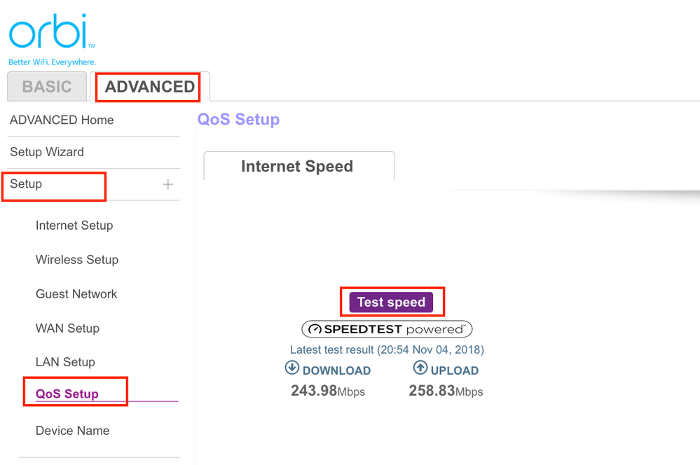

- What speed do you get when you do the Orbi built-in Speed Test?

FiberThanks, my questions were as follows:
- What speed do you get when you do the Orbi built-in Speed Test that you can find here in the web GUI:
You can also find the same testing in the Orbi phone app.
