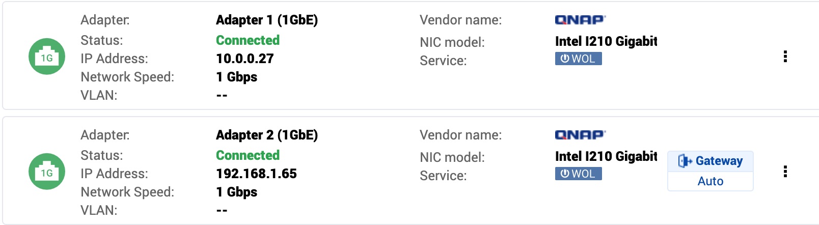

My new Orbi RBR350 pack arrived today and have been installing it and updating to the latest firmware etc. Everything working now except I cant access my QNAP NAS. It shows up in the app with an Orbi...

Sorry about the pics - shouldnt be that hard!!! They were there in the preview!
So to recap I now have the NAS plugged directly into both the Orbi and the Plusnet Router.
If I connect laptop to the Plusnet I can access the NAS through the web interface using the PN ip address. Also I can see the music server running on the NAS. I can ping it.
If I connect laptop to the Orbi I CANNOT access the NAS through the web interface using the Orbi ip address. Also I cannot see the music server running on the NAS (but I can see the music player on the Orbi subnet). I cannot ping it. With the laptop still connected to the Orbi I can access the NAS through the web interface using the PN ip address. I can ping it using the PN IP even though the laptop is connected to the Orbi.
Go figure! I am totally confused.

Image attached is the first one mentioned above...
Seems you can only attach one image at a time !

- CrimpOnMar 21, 2021Guru - Experienced User
I remain totally unable to come up with even a theory about why the NAS does not appear to devices on the Orbi LAN.
However, I can explain the other situation. When a device on the Orbi LAN (10.0.0.x subnet) tried to open a connection to a device that is not on the subnet, it sends the request to the gateway (Orbi router) which does Network Address Translation (NAT) on it and transmits it.
The Orbi's WAN interface is on the 192.168.1.x subnet, so the connection has to be on some device on the same subnet. If the IP address being sought e is "anywhere else", the Orbi will send the connection request to its gateway (the Plusnet router), which will do the same thing. Orbi ARP's "who has 192.168.1.65?", the NAS responds, and the connection is opened. The NAS responds back to the Orbi router which "un-NATs" to figure out which device on its LAN side gets the response.
It works in this direction, but not in the reverse. If the NAS tried to connect to 10.0.0.27, it would say, "this cannot be on my local LAN (192.168.1.x), so I have to send the request to my gateway (Plusnet)." It has no idea where 10.0.0.x is except that it is NOT on the same LAN. I believe a REALLY sophisticated person might be able to figure out a way to use static route (or something) to let a computer know where to find 10.0.0.x, but that is WAY above my competence level.

CrimpOn wrote:I remain totally unable to come up with even a theory about why the NAS does not appear to devices on the Orbi LAN.
I hate it when people say "Put simply..." and then go on to speak technical gobbledeegook. This is NOT one of those cases - briliant explanation that I understood! TBH I have had it with this problem now. I will ring Orbi helpline tomorrow and if I cant get a solution I will take the Orbi back and go back to the TP-Link Archer 2800 it replaced.
Thanks CrimpOn
