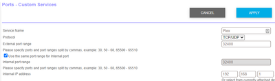

Within the orbi modem, I have setup port forwarding for the static IP address of the Plex server for port 32400 (TCP).

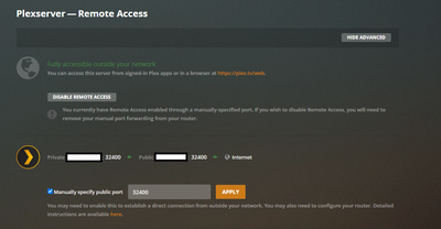

I have enabled manual port forwarding within plex for port 32400.
Plex indicates it is reachable externally:
I do not have Xfinity xFi Advanced Security (at least I do not think so as I have never explicitly set it up, and cannot figure out how to get access to it to shut it off if it actually exists.)
The server shows up to remote clients accessing the public url or through plex.tv/web, but is listed as inaccessible.
