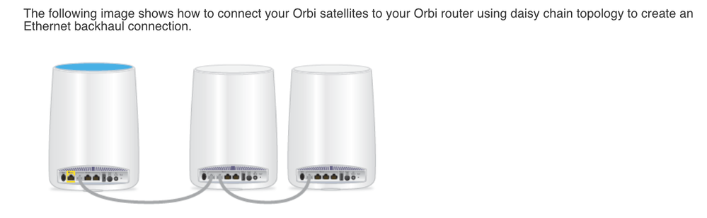

I need to provide wireless in a barn that's 150' from my house. I'm running router in AP mode. In attached drawing, can I use point to point wireless to connect Satellite 1 and Satellite 2? I would use ethernet cable to connect each Satellite to the wireless antennae at each end. It seems like I need to turn off the backhaul on Satellite 2, otherwise it will continue to try to connect to Satellite 1 in daisy chain mode, which it does occasionally but unreliably.
  • Yes you can connect Satelllite-2 to Satellite-1 with Ethernet cables if you can't connect it directly to the Router, please see below snapshot from Orbi Support Site:
      That is perfect, thanks. I could not find anything like that in the manual.
