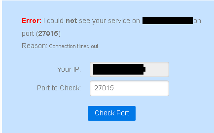

Hello. Recently I wanted to open a dedicated server for csgo, which port is 27015. But it doesn't works, I tried to make a port test and this happened. Any solution? (That's weird because I have the port opened and uPnP unabled)

Have you checked that 10.0.0.2 responds as expected on 27015 from the internal network?- SupahFoxTutor
Yep, I executed netstat -an and it doesn't appear 10.0.0.2:27015.

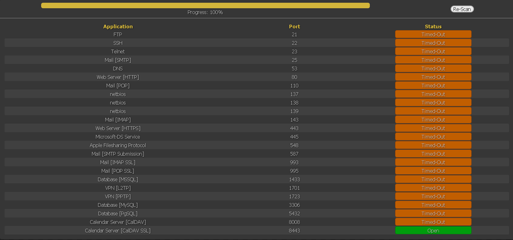

Also, I did a port test on whatsmyip and it shows me this

The modem is a ZTE zxhn f660 and yes, is connected to NG router- FURRYe38Guru - Experienced User
Modem Combo Units:
This would be a double NAT condition which isn't recommended. https://kb.netgear.com/30186/What-is-Double-NAT
Couple of options,
1. Configure the modem for transparent bridge mode. Then use the Orbi router in router mode. You'll need to contact the ISP for help and information in regards to the modem being bridged correctly.
2. If you can't bridge the modem, disable ALL wifi radios on the modem, configure the modems DMZ or IP Pass-Through for the IP address the Orbi router gets from the modem. Then you can use the Orbi router in Router mode.
3. Or disable all wifi radios on the modem and connect the Orbi router to the modem, configure AP mode on the Orbi router. https://kb.netgear.com/31218/How-do-I-configure-my-Orbi-router-to-act-as-an-access-point and https://www.youtube.com/watch?v=H7LOcJ8GdDo&app=desktop
