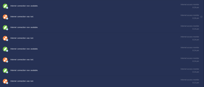

RBK50 Dropping Internet Connection constantly
So currently my setup is as follows: Bell HomeHub3000 -> Orbi RBR50 Router -> Orbi RBS50 Satellite -> Desktop PC
It's set up in a wired Daisy-Chain Topography and the Desktop PC is hardwired from the RBS50, so everything is using Ethernet Backhaul.
I'm having an issue not where I will lose connectivity to the internet to where it will drop and reconnect multiple times before working for another random amount of time. Today it has happened every couple hours, where yesterday it happened 5 times in less than 2 hours.
I have also tried removing the RBS50 from the equation and connecting my PC directly to the RBR50 and it's doing the same thing, it seems to be the RBR50 itself that is causing the drops but at the same time there is nothing showing in the logs as far as a Internet Connect/Disconnect goes.
I have done a factory reset on both the RBR50 and the RBS50, I use Glasswire sometimes to monitor my traffic and this is what the Internet Access Monitor is telling me:

  • *Update*
    I disabled "Automatically adjust for daylight savings time" and changed my NTP to "time.google.com" instead of the Netgear deault and I have not had a single issue since.
    Pretty sad considering I dug this solution up from a post from March of 2019, that had people from March of 2020 posting the same issue and here we are in November 2021 having the same issue multiple firmware revisions later.
