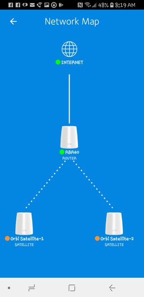

I've been having issues with my Orbi RBR40 Units with 2 satellites since I've bought them in Dec. It was purchased brand new from Best Buy, and after installation everything ran smoothly. Maybe a few...

I use Comcast and get 160mbs. My modem is a Netgear CM1000 docsis 3.1
I have a small 2 bedroom home no more than 1000 square ft. I have one satellite in the garage and one in the front room of the house.
Its default settings, so I'm assuming channel is auto. I can try to switch it and see if that works.
Thanks for help.
Thanks for help.
- FURRYe38Aug 15, 2018Guru - Experienced User
For a 1000sqft home, you have the base and two satellites running? You should only need the base router and maybe the one satellite out in the garage at 30feet in between minimum.
