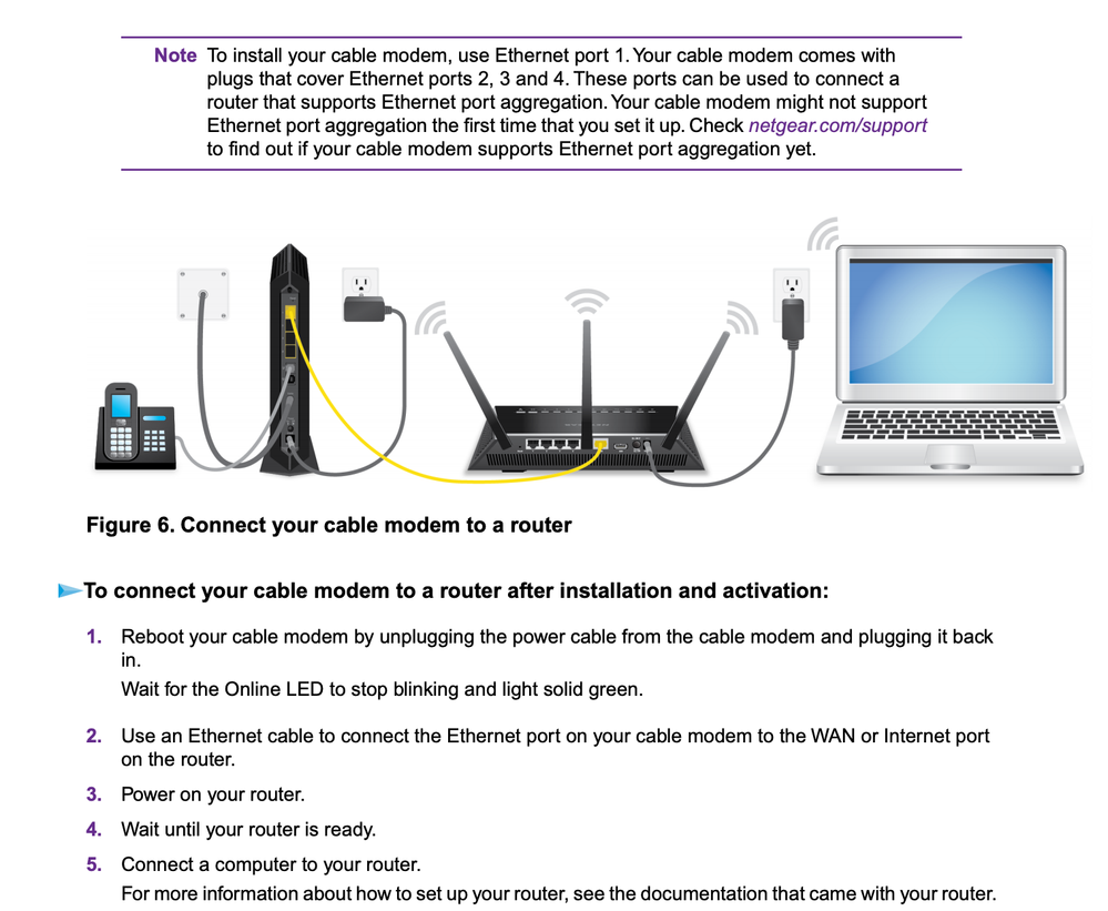

  • Have you followed the instructions in the manual to connect the cable modem to a router as follows:

      Thank you ... I completely rebooted the CM1150V, Orbi and the satelites and the network is now back to 180 mbps.
      I see where I went wrong, I just turned off/on the Orbi when I installed the CM1150V and did not go through the process of restaring everything from scratch.  Thanks again.

        Glad you got it working. Yes, when chaning Modems or routers. It's always best to power both systems Down, make ths change and then power the modem on first, then router.
