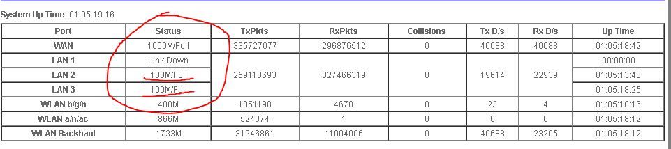

    The Orbi is reporting 100/Full on both ports. Nothing will ever measure more than about 95mb/s when the Link is set to 100. That means either the cable or the ethernet port on the other end of the cable is not autonegotiating 1000/Full.  https://en.wikipedia.org/wiki/Autonegotiation The Orbi cannot detect anthing but the first device on the other end of the ethernet cable, so that is the place to focus.

        I would be tempted to get a flashlight and look closely at the ethernet jacks on the Orbi router.
        100base-T requires two pairs of wire.
        1000base-T requires four pairs of wire.
        I know that this is rare, but I have seen instances where one of the tiny wires inside an ethernet jack is bent and is not making contact.  If one wire in a jack does not connect, it cannot possible support 1000base-T.
