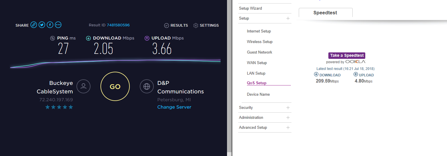

I purchased the RBR50 some months ago, and I've recently begun to see two significant issues, one that I think people have quite a bit of experience with (frequent router reboots, even on the latest ...

The current modem is a Technicolor CGM4231 operating in bridge mode. I don't recall what the previous one was before I swapped it for this one. Actually, now that I think about it we have had a total of three modems over the life of this issue, as the one I was using when I opened it died and I picked up this latest one from the ISP.
I have already updated the firmware on the router. It's the latest 2.2.1.210 as noted in that release item.
