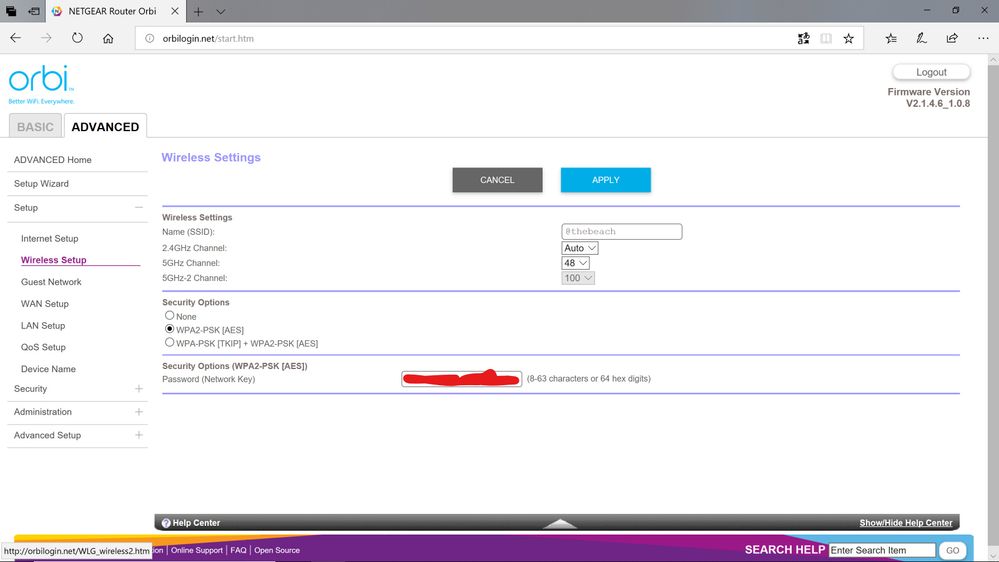

- PfreddJul 27, 2018Guide
There is no "Daisy Chain" option on my CBR40. It has the latest firmware.
Here is a screenshot of the Advanced Wireless Setup screen:
- FURRYe38Jul 27, 2018Guru - Experienced User
You need to post this over on the CBK40 Orbi with Cable modem. There are some differences between the CBK40 and the non cable Orbi systems. RBKs.
